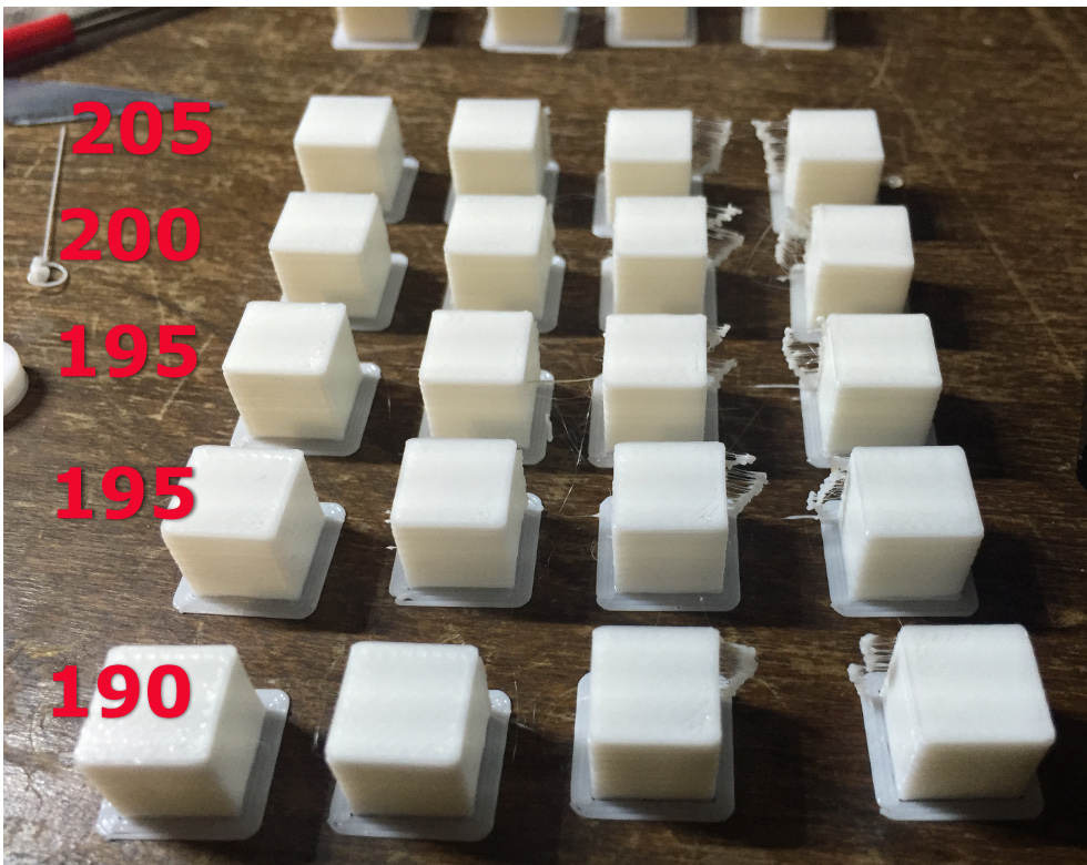

Here's a photo of the results with different temperatures. There are two rows of 195 because I used two different filaments.
retraction cubes.JPG (311.59 KiB) Viewed 10976 times
Toy
Posts: 116
Joined: Mon May 16, 2016 8:40 am
Re: I3 Pro B - oozing
Post by Toy »
Here's a link that may help you, please check it:
https://www.simplify3d.com/support/prin ... -or-oozing
