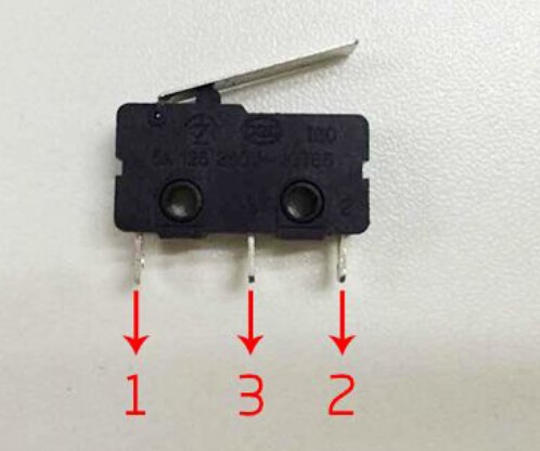

Make sure the wire is corrected to pin1 and pin2
it should be connected to min socket.
If you find a endstop doesn't work, you can plug it to other axis, see if the endstop is defective.

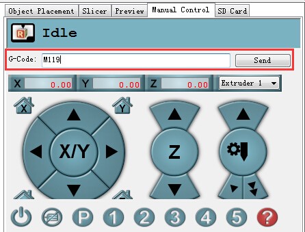

You can also use M119 code to check if the endstop works.
Homing the printer first, and use M119 to check the endstop status. If the printer can not home itself, you can manually trigger the endstop one by one.

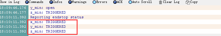

Then you'll get
18:10:11.392 : x_min: TRIGGERED
18:10:11.392 : y_min: TRIGGERED
18:10:11.392 : z_min: TRIGGERED

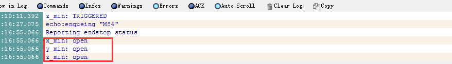

Then move the extruder from the endstop, send M119, and you'll get
18:16:55.066 : x_min: open
18:16:55.066 : y_min: open
18:16:55.066 : z_min: open
