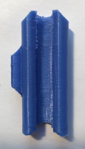

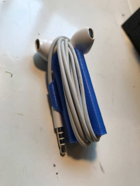

Do you have a 100% original printer or have you changed parts? I changed the stepper voltages to about .8V. I put washers on any diagonal rods that had slop in them. I put elastic between the pairs of rods. And, probably most importantly, I stiffened the spring of the extruder with a shim. (I just received metal extruders but have not put them in yet.)
Could you complete the following table of print settings? :
3D part printing sheet:
0) Printer Brand:
1) Model of the printer: M301
2) Name of drawing OBJ or STL: iP5-earbud-wrap-02.stl
3) Diameter of the nozzle: .4mm
4) Material used: PLA
5) Material color: Blue
6) Manufacturer of material:
7) Material Diameter: 1.75mm
8) Nozzle temperature: 190° C
9) Plate temperature: 60° C
10) First layer: 0.3mm
11) Other Layers: 0.2mm
12) Number of outlines: 2
13) Filling%: 20%
14) Print Speed: 20 mm / s
15) Travel speed: 60 mm / s
16) Acceleration speed: mm / s
17) Extrusion speed: 20 mm / s
18) Retracting:1 mm
19) Retracting speed:20
Ascertainment :
Respect of dimensions:Good dimensionally
General impression : Good shape with even lines and corners. Printed standing vertical which I could not do on my Printrbot Simple without knocking it over, especially at .2mm layer height. Used Slic3r 1.2.9 on Mac, printed with Octoprint on Raspberry Pi
Correction required:A lot of strings but easy to remove

Merci pour toutes les informations et la photo !
Vous auriez d'autres photos qui montrent davantage le fini des impressions ?
Donc, vous diriez qu'avec une cale de renforcement des ressorts des pinces d'extrudeur et réduction drastique des vitesses (divisé par 4 au minimum) vous avez de bonnes impressions ?

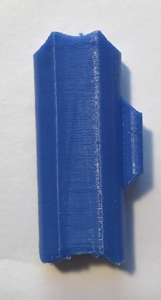

Well, good impressions may be overstating it a little. I'm now hopeful that the quality will improve. I still want to print in ABS and, of course, with multiple colors which is the point of the mixing hot end.Lami René wrote:= = = = = = = = = = = = = = = = = = = = = = = = = = = = = = = = = = = = = = = = = = = = = = = = = = =
Would you have more pictures that show the finishing touches?
So you would say that with a spring reinforcement shim extruder clamps and drastic reduction in speeds (divided by at least 4) you have good impressions?
Cordially,
Friend René
Attached are a couple of more pictures. I did not take a photo before cleaning up the strings.
--Dave
