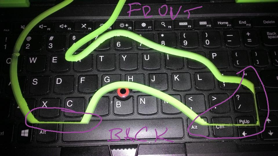

I am trying to center prints on the bed...and using BLTouch, which homes in the center...there is a 13mm X offset to all prints...I am using Cura
I have tried M206 X13 to shift the bed position, but while the printer accepts it, it does not seem to actually work....its not reported in M503
how do I center prints? (SLIC3R has an offset in printer profile, Cura does not)...

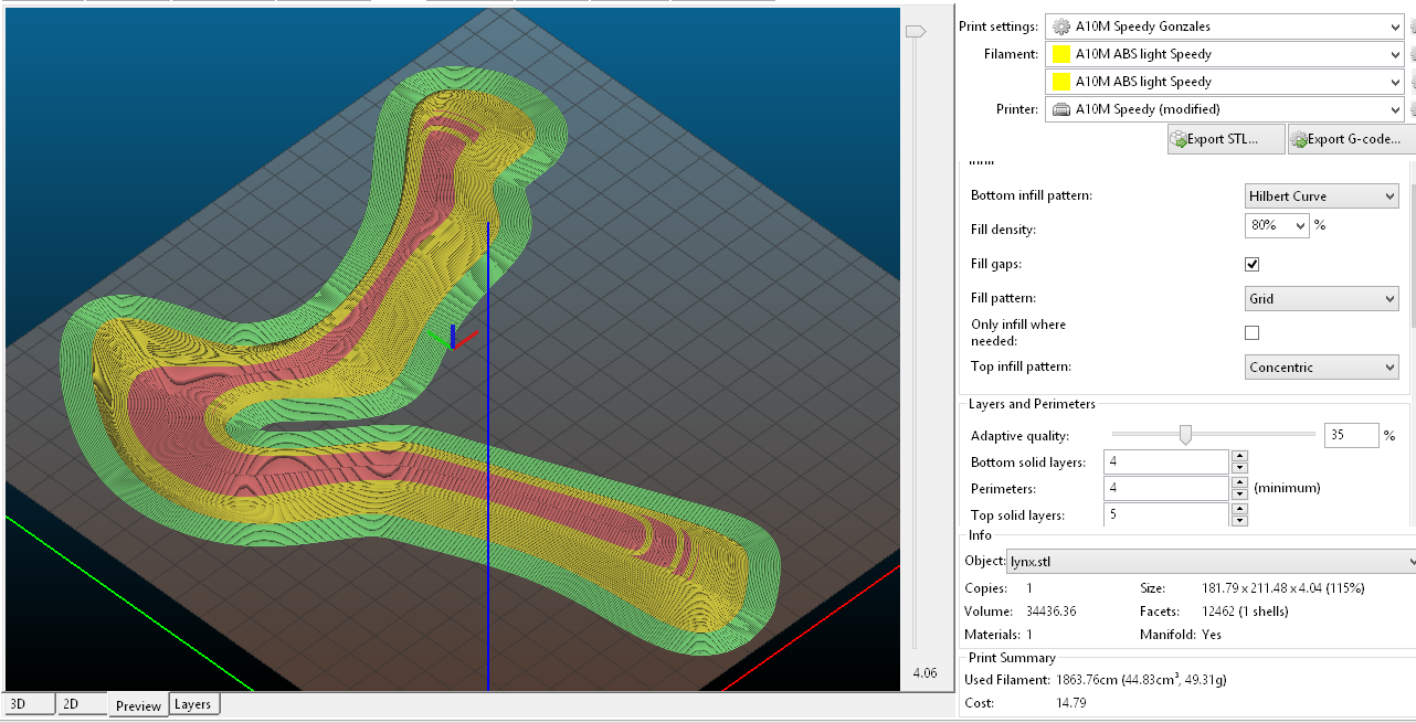

There are some hard coded software limits to bed size in the printer?
See what it does on bigger print
And settings
and what it si sliced

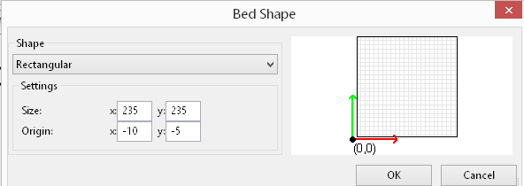

Bad news. Hardcoded nice 220, but real printable size is X210 x Y215. Look at offset 10x5mm.
Why not to use real printable size at least 230x230mm? There are tolerances 5mm (which is really needed, machinery precision of complex object is not good - if you did not see it, you are lucky or blind).
A10 Slic3r profile: here
