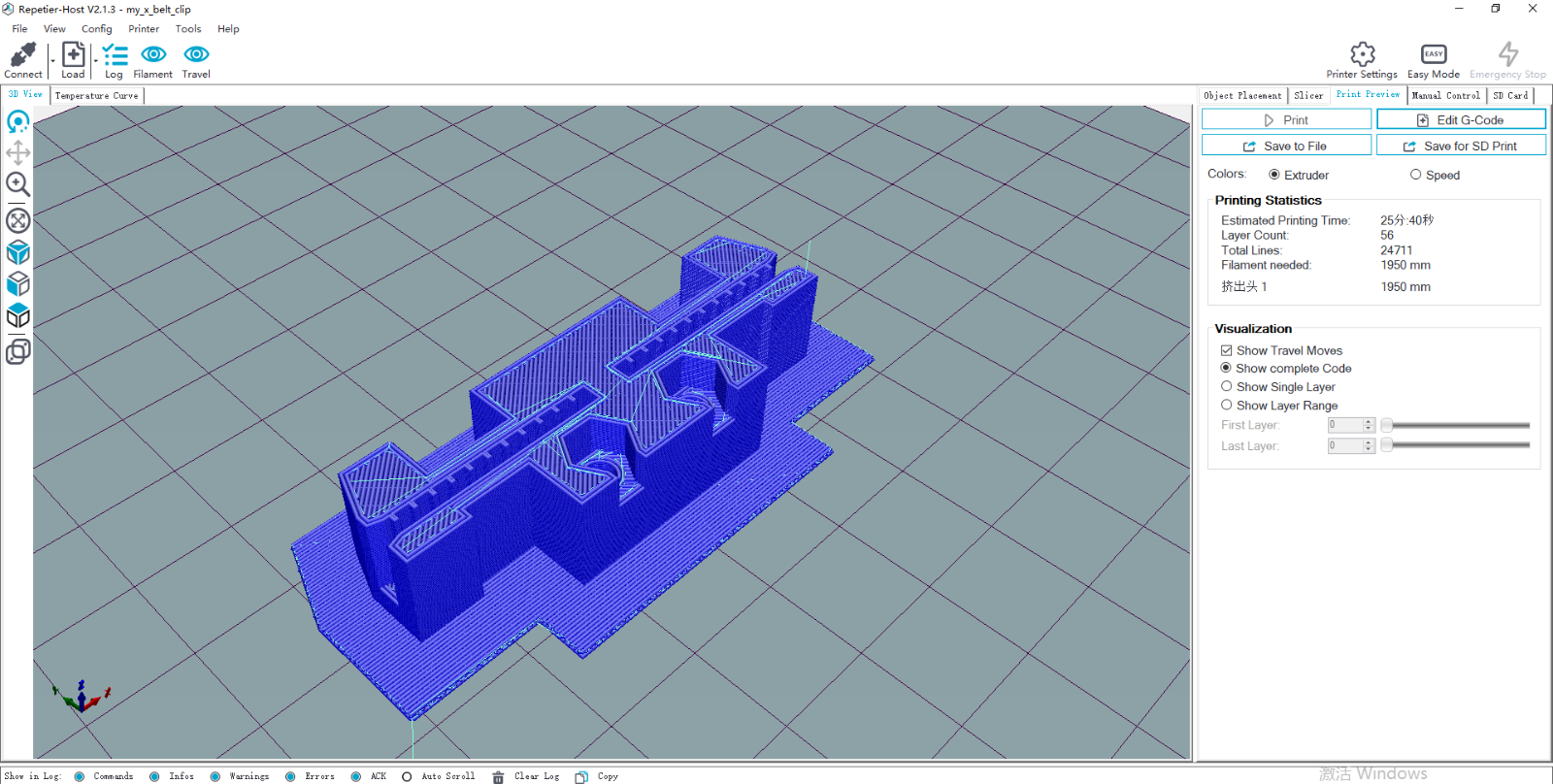

Hi, I tried to slice it,
The preview after slicing is like this:

Interesting ... thats NOT what I get :-(
What settings are needed to get that - I am pretty well using the defaults.
It seems that you are using RH v2.1.3 and I am on v2.1.6 --- I wonder if that could be the problem ???
