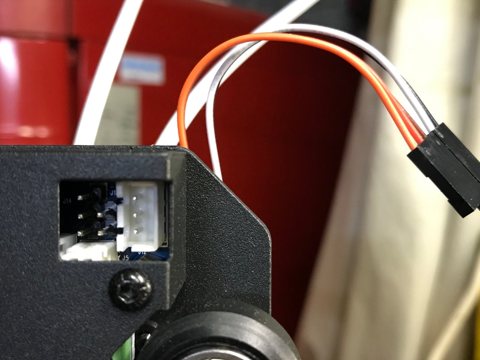

perfect thanks... the servo pin is 27?theju wrote: Thu Nov 07, 2019 3:15 pmHere the photo much easier to understand.
Does anybody know what is the 3 poles connector under ?

Hello,
i have a different one kind of connexion on my A20M printer head.
Can anyone tell me how to connect 3D-Touch on this head?
Thanks,
H.

Re: New A20M Model ?
Same model same question, how to plug the 3Dtouch ?
Hallo,
upper are grounds ...
Wi
Wi
As seen on a video ( from Geetech )
brown -
red - black
orange - white
