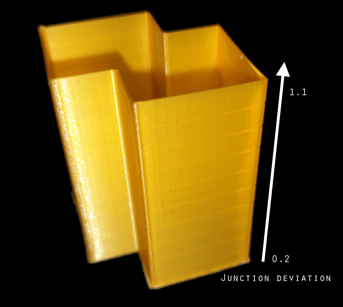

I also have tried a junction deviation test print's (see picture), but I cant see any difference, why ?

junction deviation gets better the lower the value the default in marlin 2 is 0.013 you tested from bad to worse not better.
Haa ok ! I understand, So I will try another range.
