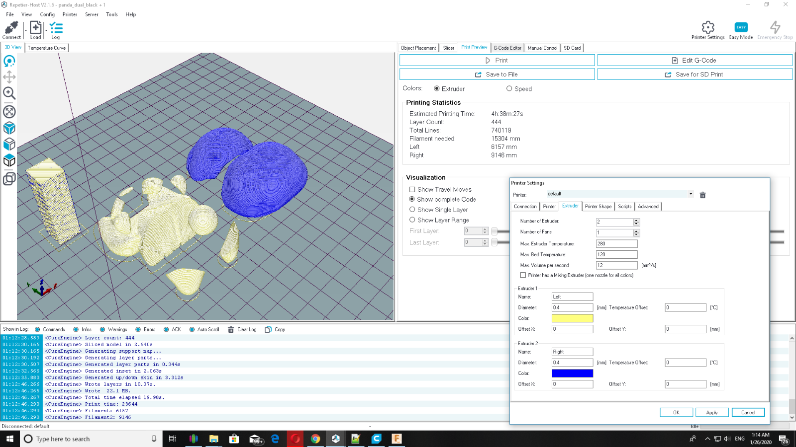

Our try (today), please check

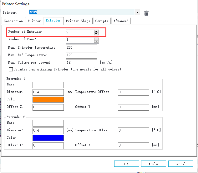

Re: Geeetech A30M profile setting for Simplify3D and Repetier-Host
uncheck : printer has mixing extruder
but you may need to play retraction and purge tower size
i did not try. you will need to test

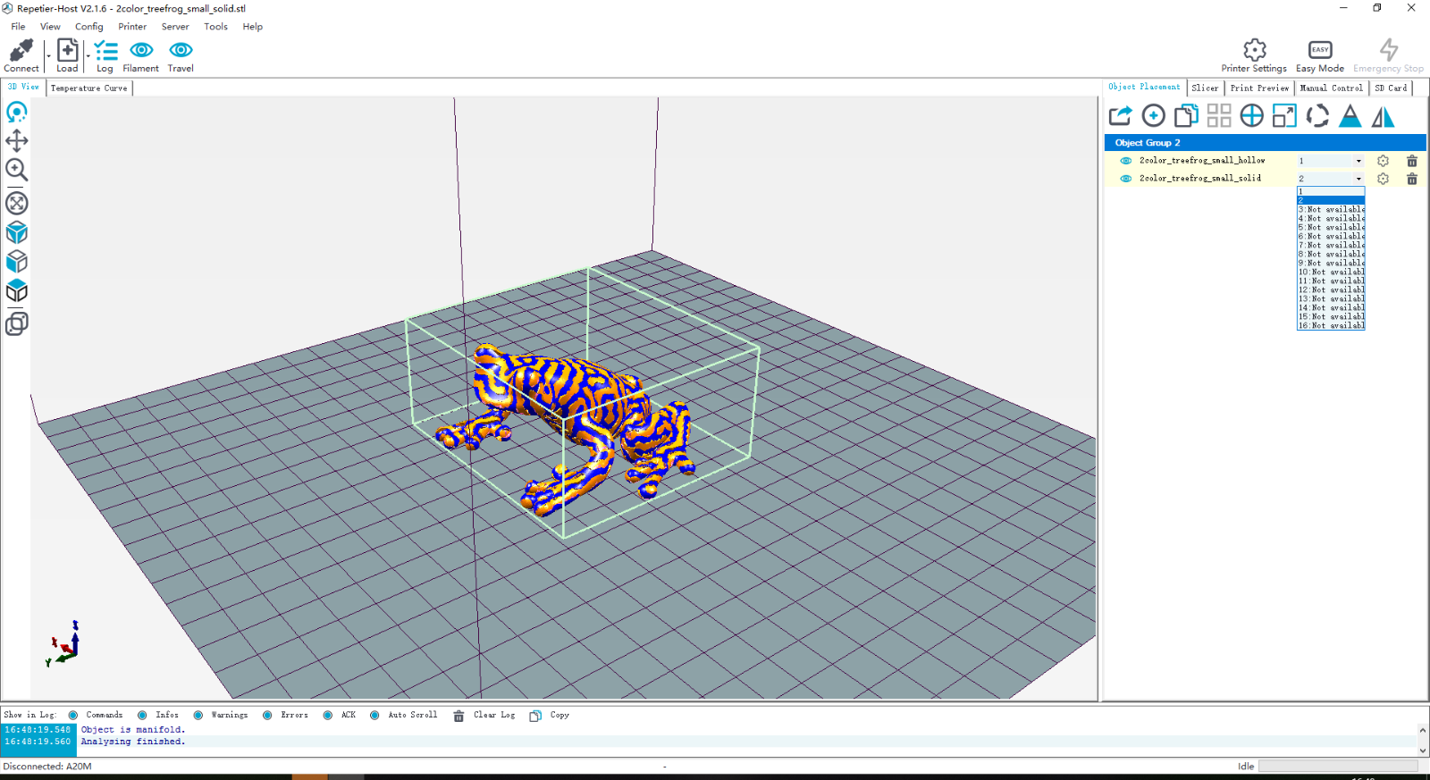

hello,
Printing multiple files at once (repetier-host)
Set multiple print heads in settings Set different files to different extruders
Hi, please send us this model for test
