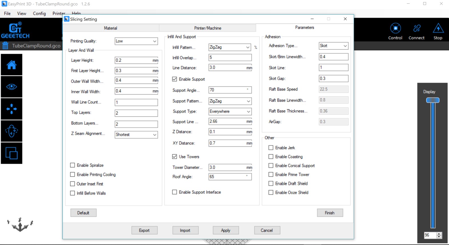

settings
settings
Problem settings 1.jpg (135.42 KiB) Viewed 12085 times

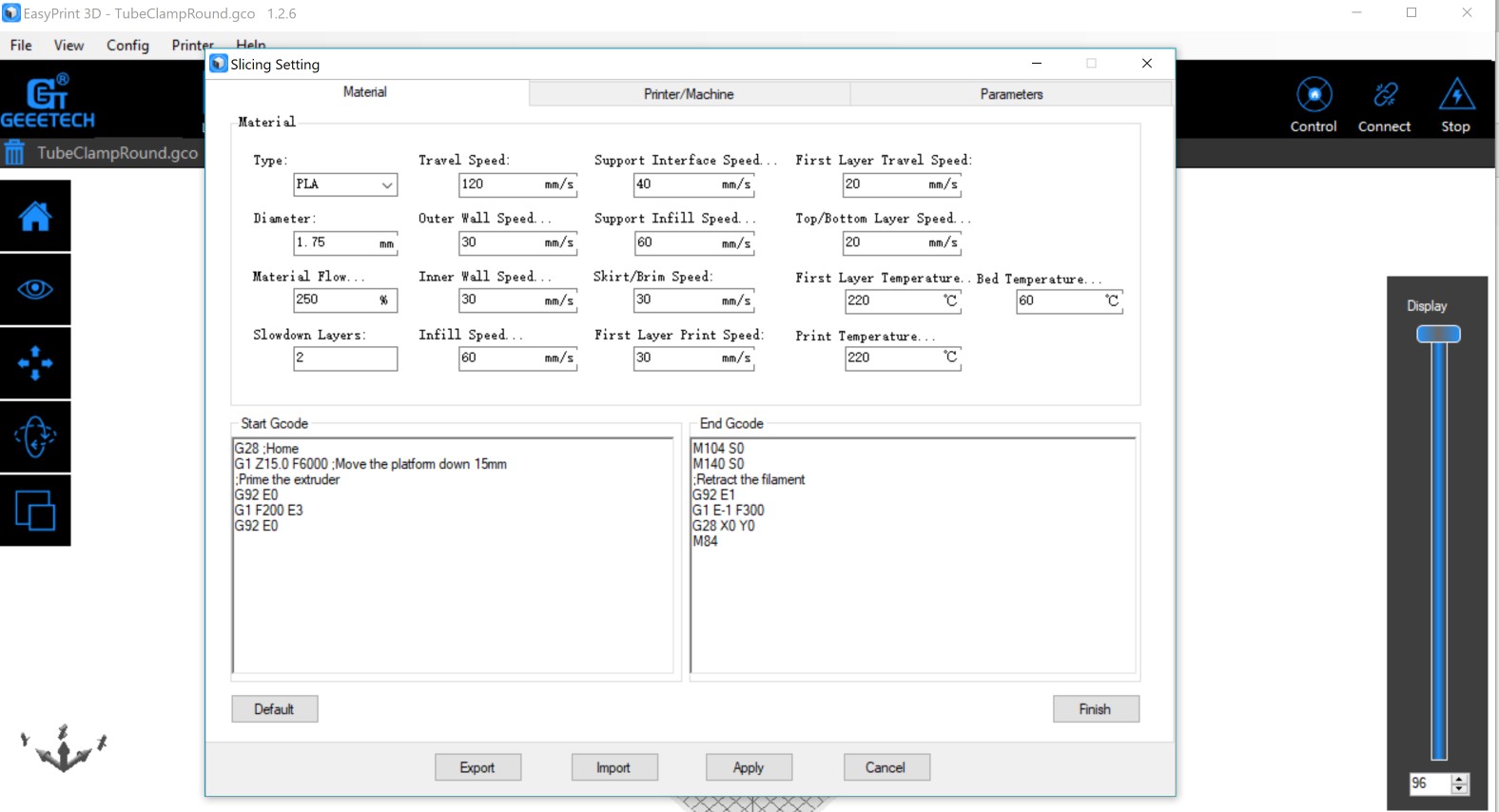

settings
settings
Problem settings 2.jpg (129.21 KiB) Viewed 12085 times
settings
settings
Problem settings 3.jpg (152.19 KiB) Viewed 12085 times

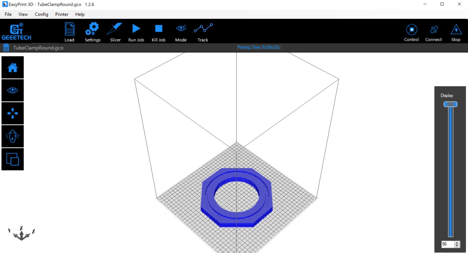

Part to be printed
Part to be printed
Problem settings 4.jpg (126.73 KiB) Viewed 12085 times

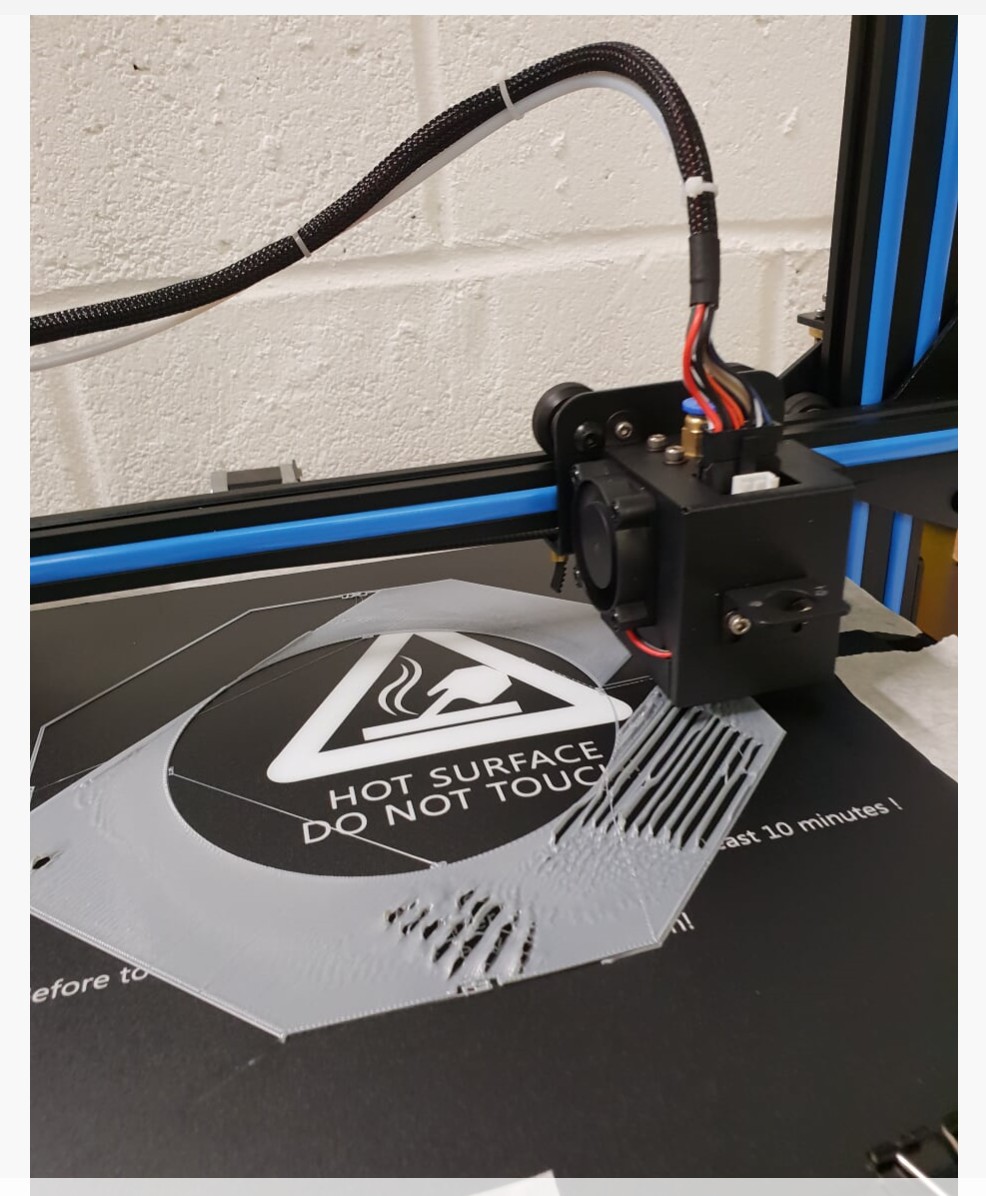

Part Being Printed
Part Being Printed
Problem settings A.jpg (198.3 KiB) Viewed 12085 times

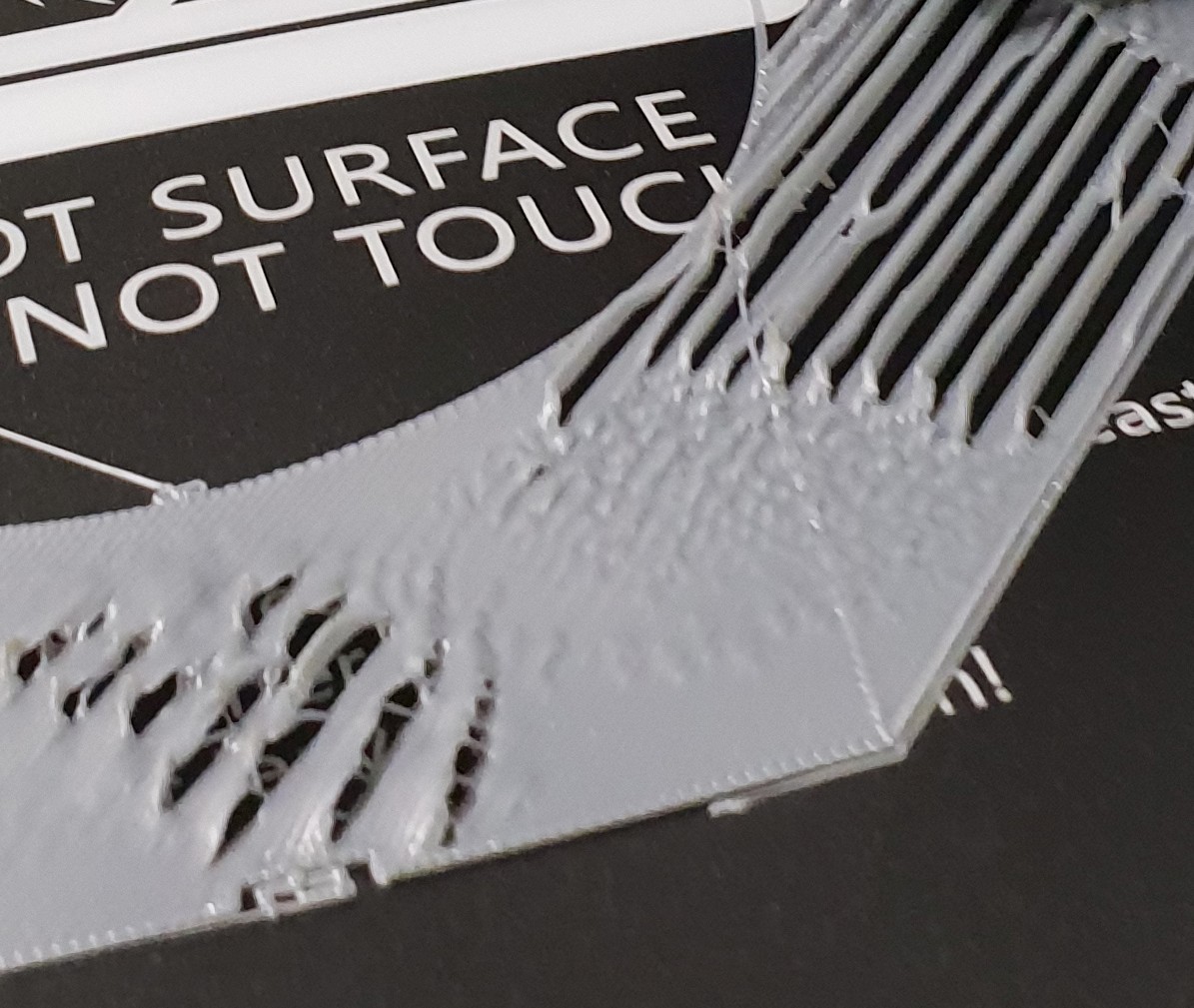

Close up
Close up
Problem settings B.jpg (295.56 KiB) Viewed 12085 times

Parameters important for the first layer are:
  • slower printout,
  • increased dosage of filament,
  • leveled surface,
You have also paid attention to improving adhesion to the ground.
So you are no longer newbie. :D
I did not see in the presented configuration a parameter determining material feeding. :roll:

I will try slowing down the first layer.
I have tried 200 - 205 - 210 and 220 for the nozzle temperature.
Not sure which parameter in the settings is "material feeding" the 3 pages I included seem to be the only ones i can adjust - Its EasyPrint 3D and the manual that comes with it doesn't really go into detail about each parameter.

I don't use PLA, but I reduced the thickness of the first layer, setting it like the rest.
But I have set the filament feeding to 130% (with a layer thickness of 0.2mm).

Thank you for your help Kaktus,
Changed 1st layer height from 0.3 to 0.2mm
I slowed down the first layer speed to 25mm/s from 30
and the material flow from 250 to 225%
All other settings the same.
And Viola it worked.
