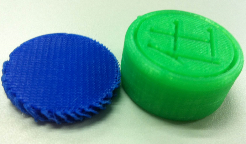

Your slicer setting is so bad. Look at the picture, the blue one , which is so bad that I even don't want to continue printing, is printed with your settings, and the green oneis printed with my settings. You can try my settings (attachment), and modify some parameters properly as I suggested you before .

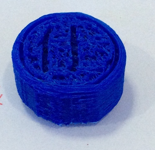

I try to load chinese chess like yours for compare
Overall about pitting , hole and first layer it is better :)
But I see new problem :)

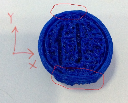

I think my x or y or ? axis will be problem
FullSizeRender (56).jpg (77.15 KiB) Viewed 13751 times
FullSizeRender (57).jpg (77.87 KiB) Viewed 13751 times
Could you seggest me ?
My circle chess it is not round and top surface not smooth .
Thank in advance ^^

Turn off the printer, is it easy to manually move X and Y axes?
begizmo
Posts: 31
Joined: Sat Mar 14, 2015 12:04 am
Re: Pitting , Hole , Defect on printing
Post by begizmo »
Yes it easy
zhangxueyou
Posts: 1405
Post by zhangxueyou »
Tighten the belts a bit, not too much. Maybe they are too loose.
