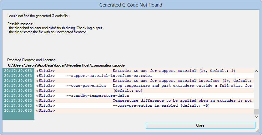

Loading via the lower version seemed to work,
I also have a problem with the slicer
I attached a photo of the issue
Please advise
6-15-2015 8-18-13 PM.png (39.52 KiB) Viewed 11020 times
zhangxueyou
Posts: 1405
Re: Y- Axis Failing
Post by zhangxueyou »
You can refer to this page to set your printer in Repetier first:
http://www.geeetech.com/forum/viewtopic ... 21&t=16512
