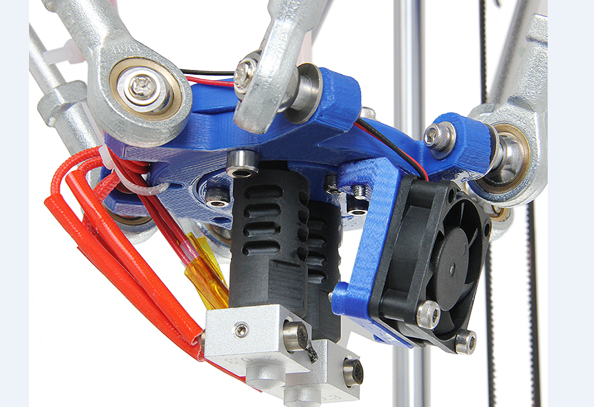

Re: Extruder fan
The hotend fan only has two wires,as pic bellow. you can swap the fan with coldend fan to check if the fan was dad or not .
- fan.png (668.98 KiB) Viewed 15161 times
