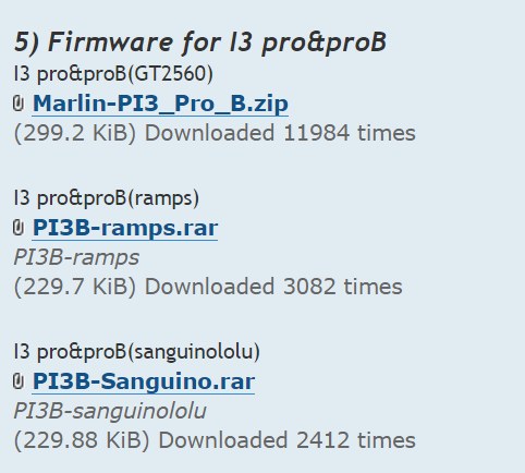

You can find it in page 1 of this post.Download your related version.

The files you provide are wrong.
I have an i3c pro C printer with firmware 1.0.02,
I am updated with the firmare you provide on the web and now the version that appears is the Marlin 1.0.
And worse the x-axis direction has been reversed, disabling the printer :shock: :shock: .
6) Firmware for I3 pro C
I3 pro C (GT2560)
Marlin_GT2560-PI3_Pro_C.zip
(299.21 KiB) Downloaded 6261 times
I3 pro C (ramps)
PI3B-Ramp14-2E.rar
PI3B-Ramp14-2E.rar
(268.97 KiB) Downloaded 1683 times "
