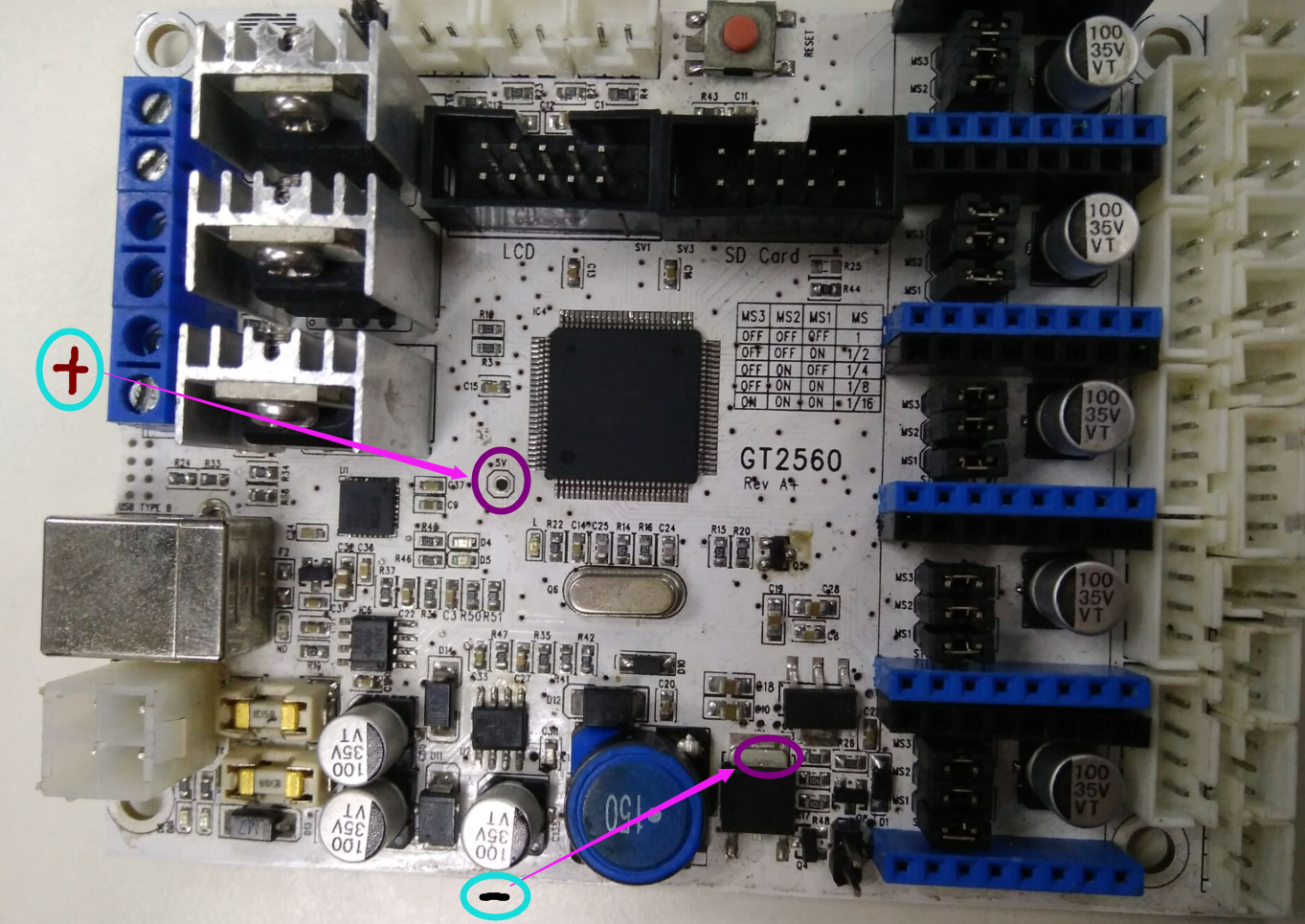

You should use multimeter test the voltage of mainboard in here:
- voltage.png (1.64 MiB) Viewed 9439 times
- FrancYescO
- Posts: 0
- Joined: Tue Oct 17, 2017 6:53 am
Re: GT2560 Only work with USB plugged in
[quote=William post_id=81340 time=1509961423 user_id=51382]
[/quote]
Just tested, witouth USB power supply voltage here is just 1.65v
where is the issue?
[/quote]
where is the issue?

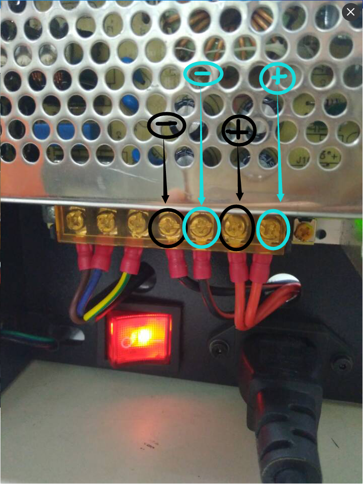

It seems not enough power supply for the mainboard.You should test the voltage in power supply(normal is 12V) :
- powersupply.png (745.72 KiB) Viewed 9424 times
- FrancYescO
- Posts: 0
[quote=William post_id=81346 time=1510019336 user_id=51382]
[/quote]
Voltage on both connector is 12.20v i assume is okay
[/quote]
It seems you need a new mainboard, contact related after-sale for help.
