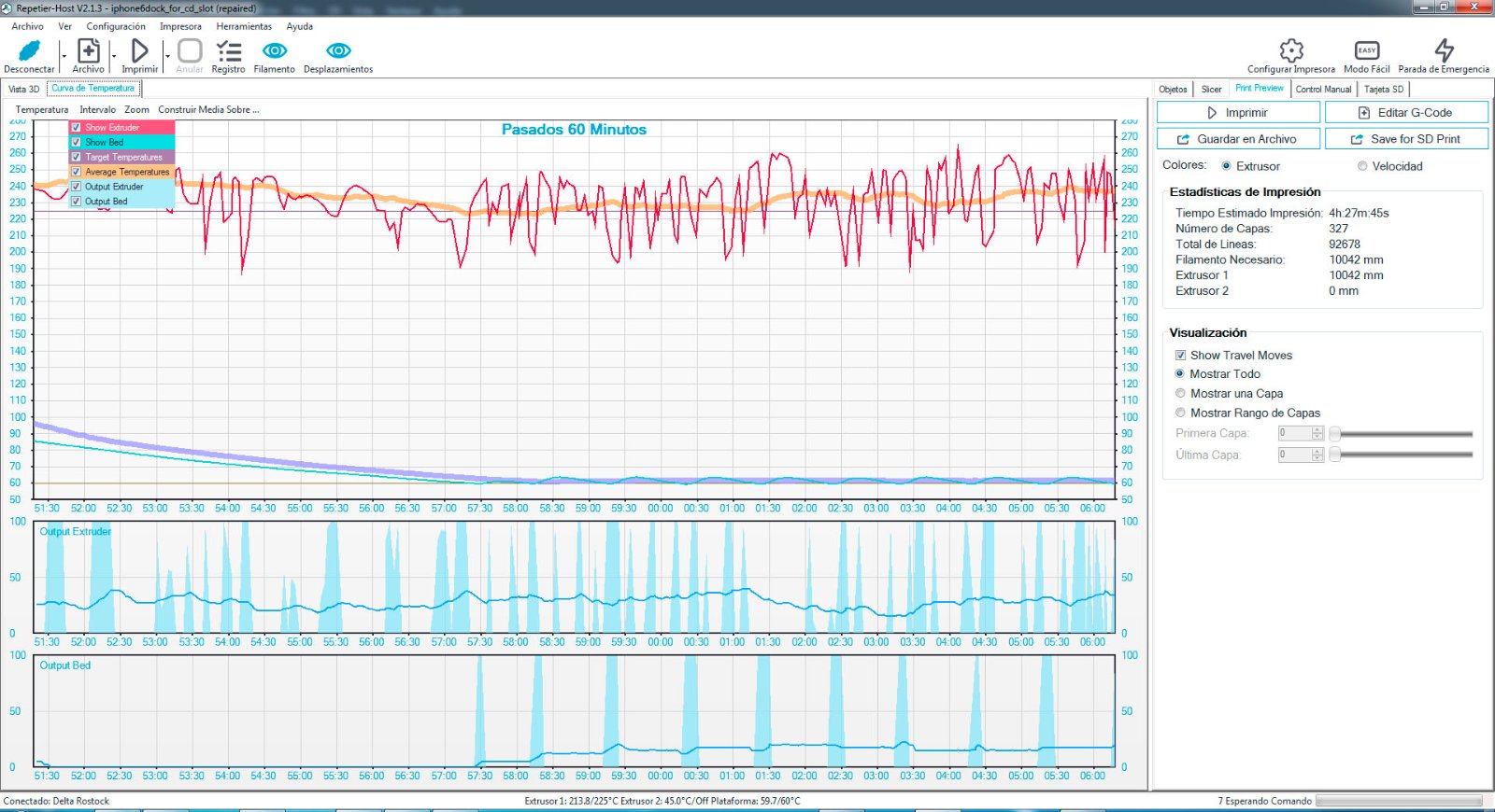

Have you seen the temperature chart in RepetierHost?
Can you show the screen :?:

hi here is the screenshot of the problem
problema temperatura.jpg (278.38 KiB) Viewed 13520 times

Hello everyone, thanks to everyone, it is noted that in this forum is supported, I already solved it were thermistors, thanks for your help
