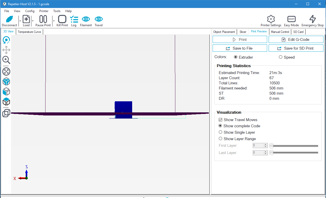

Hello everyone, I have a PI3 PRO C, SW 1.0.04.
The problem is the z axis: when print begins, it starts at 10 mm above the bed.
I use Repetier.
Any idea?
Thanks.

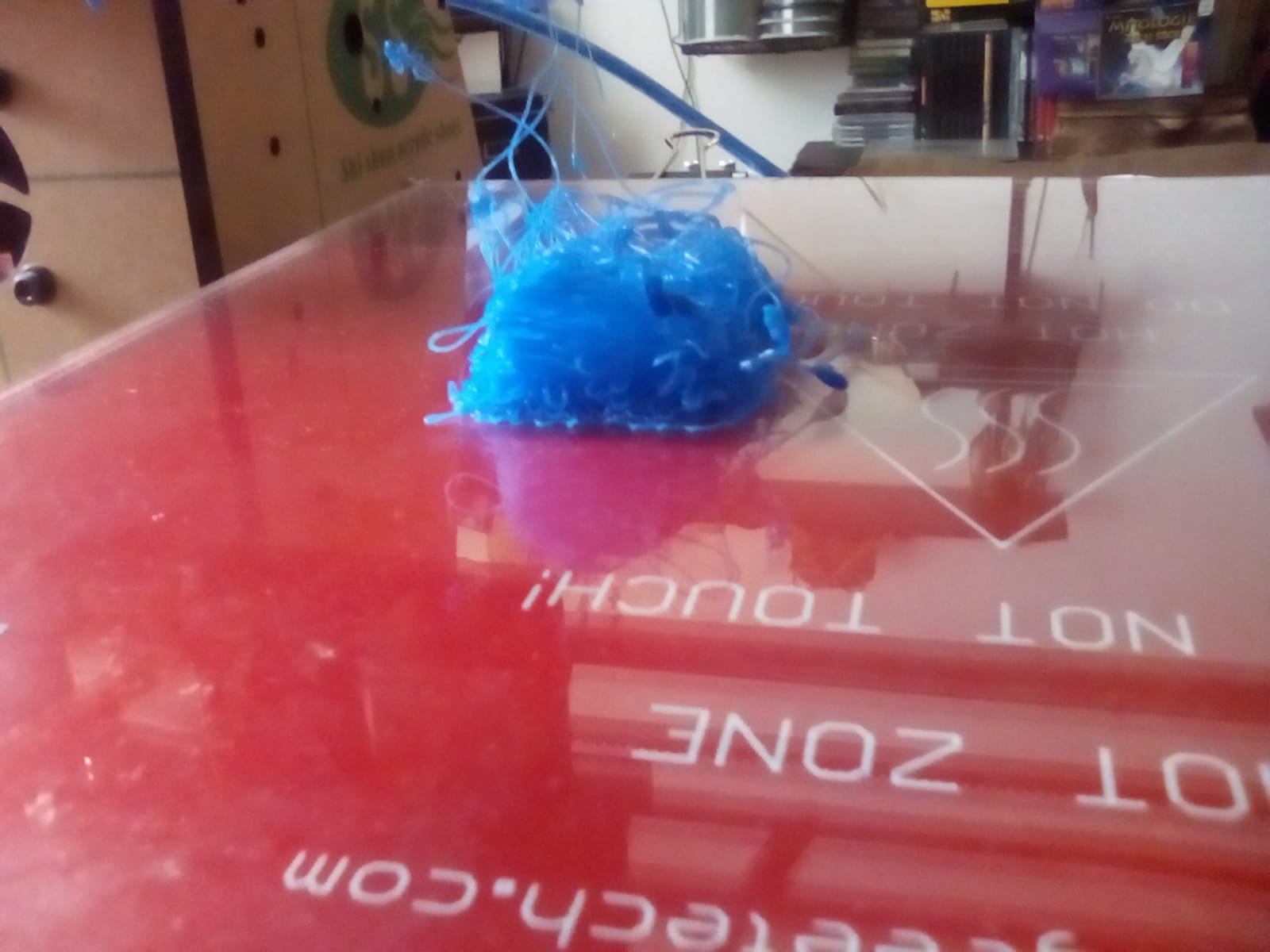

Post by ddanos »
Yes, the bed is leveled and the home point is perfect.
Here you have a video https://youtu.be/F53eqbg-bfQ
Thanks.

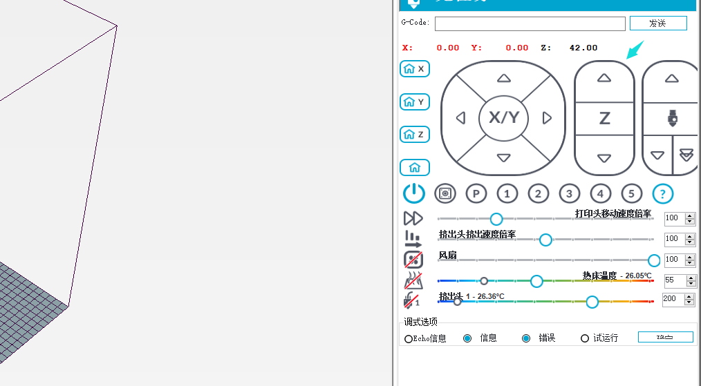

Re: + 10 mm Z axis at beginning printing
Hi, you can do this to move the Z axis.
