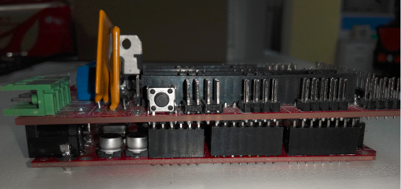

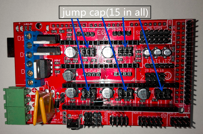

Ramp1.4+Mega2560
Jumper caps

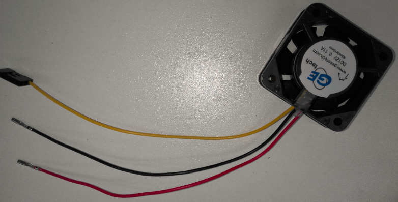

Cooling fan for mainboard
Cooling fan.png (397.42 KiB) Viewed 36976 times
Cooling fan2.png (524.28 KiB) Viewed 36976 times

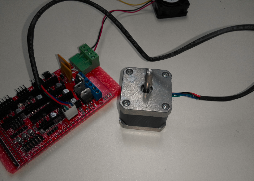

Extruder motor
Extruder motor wiring.png (601.39 KiB) Viewed 36976 times

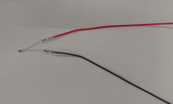

Themistor on hotbed
Thermistor on hotbed2.png (183.19 KiB) Viewed 36976 times
Thermistor on hotbed.png (806.05 KiB) Viewed 36976 times

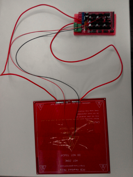

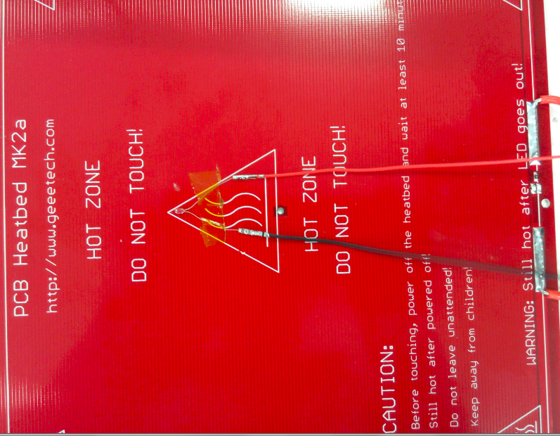

Hotbed
hotbed wiring.png (345.6 KiB) Viewed 36976 times

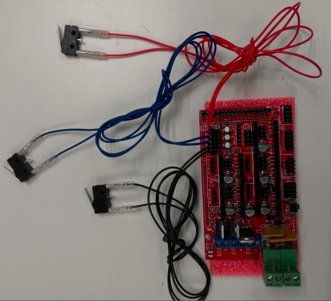

Wirng of Endstop
wiring of endstop.png (557.72 KiB) Viewed 36976 times

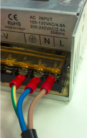

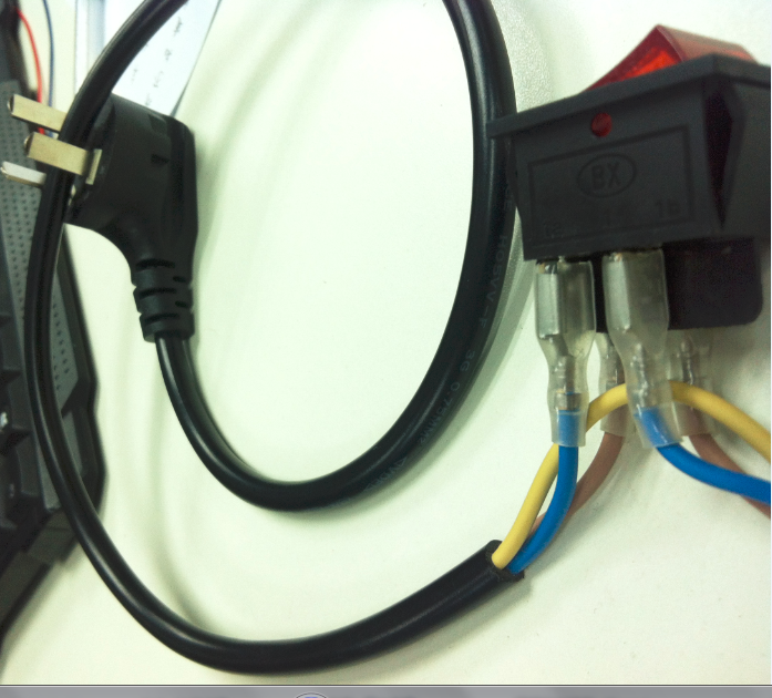

Power supply
Power supply wiring2.png (195.88 KiB) Viewed 36976 times
Power supply wiring.png (635.95 KiB) Viewed 36976 times

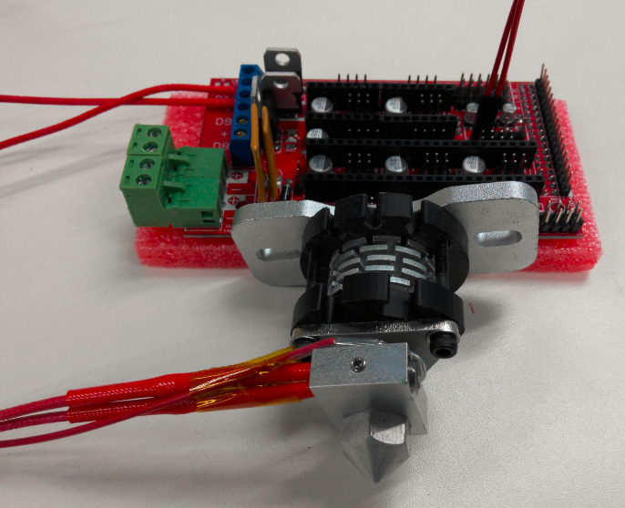

Wiring of extruder
Wiring of extruder.png (534.37 KiB) Viewed 36976 times
Wiring of thermistor for extruder
Wiring of themistor for Exturder.png (419.83 KiB) Viewed 36976 times

Switch
