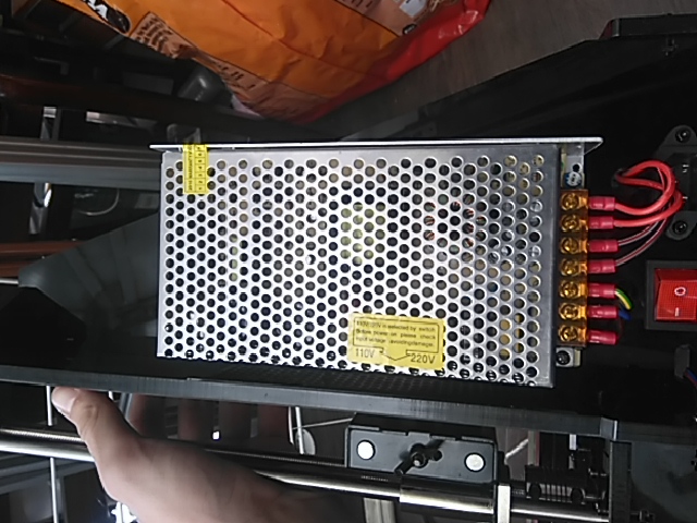

I have not tested with a multimeter yet, but here is a picture of the wiring.

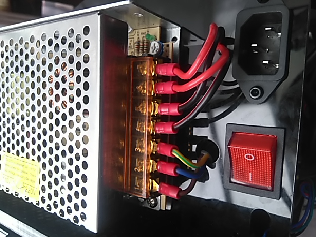

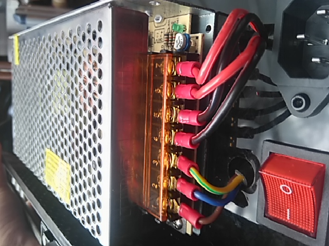

i have yet to test it with a multimeter but here is a picture of the wiring to the PSU.

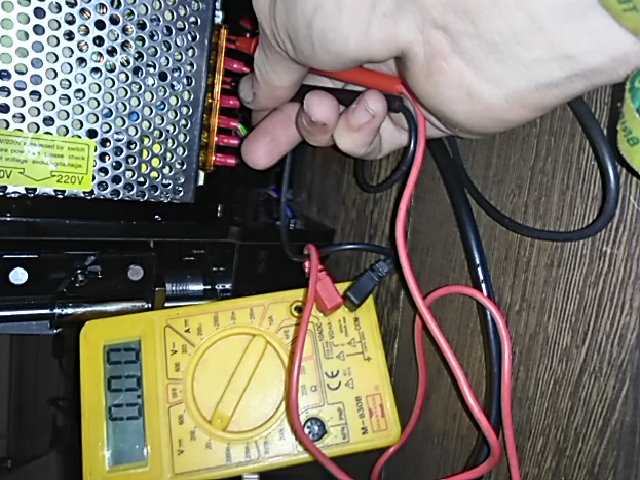

You can test the voltage between the red wiring and the black one when you power on,so as to confirm if the PSU is a bad one.
Attach the pic of multimeter displaying plz.

Here is the multimeter test on the red and black wiring.
Re: Power supply not working
Coffeeownsyou wrote:
Contact the seller for a replacement plz.
