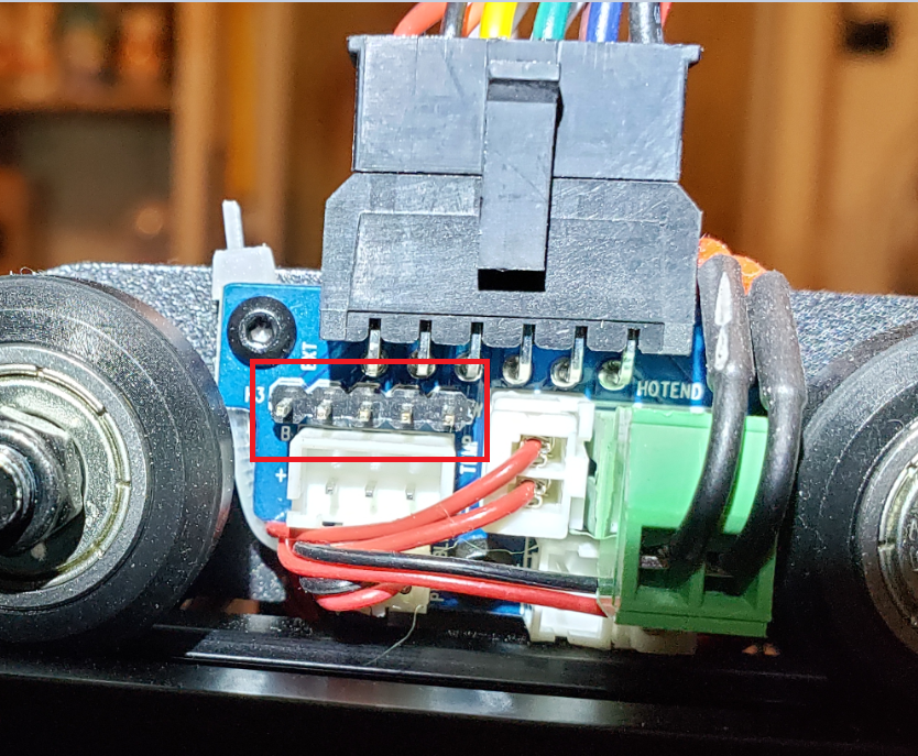

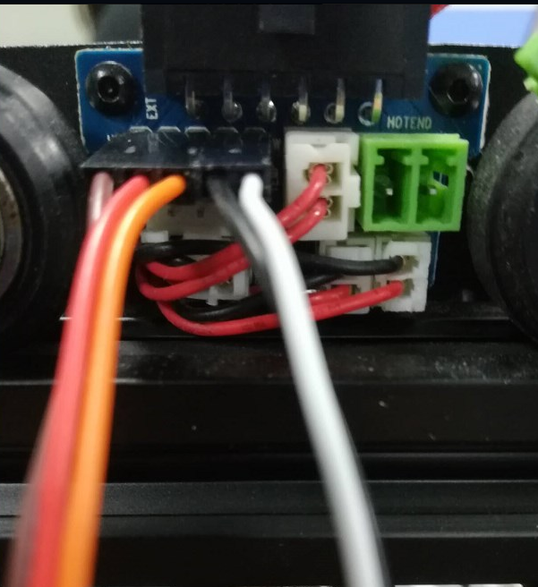

I want to install a 3DTouch auto bed leveling sensor on my A30.
Did these pins on the back of extruder are for connection ? P.S. see picture.
Anyone has a picture how these plugs are connected ?
Do i need a firmware update ? or just connect the auto leveling sensor and do the setup on the lcd screen ?
Thanks
Thanks

Hi,this is the connection diagram:
You can refer to this:
http://www.geeetech.com/wiki/index.php/ ... ing_Sensor
you need to change the firmware and update. You can refer to this:

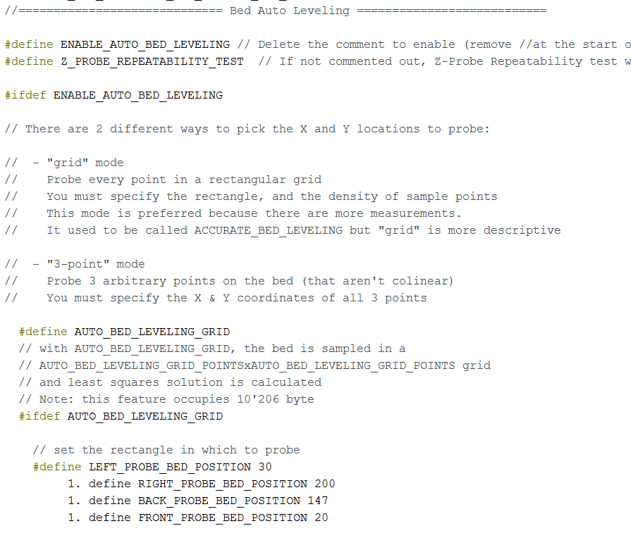

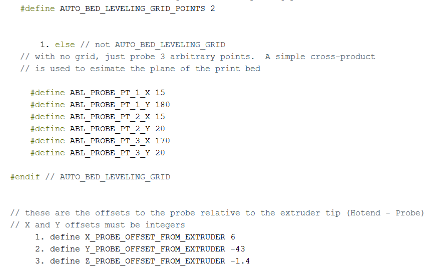

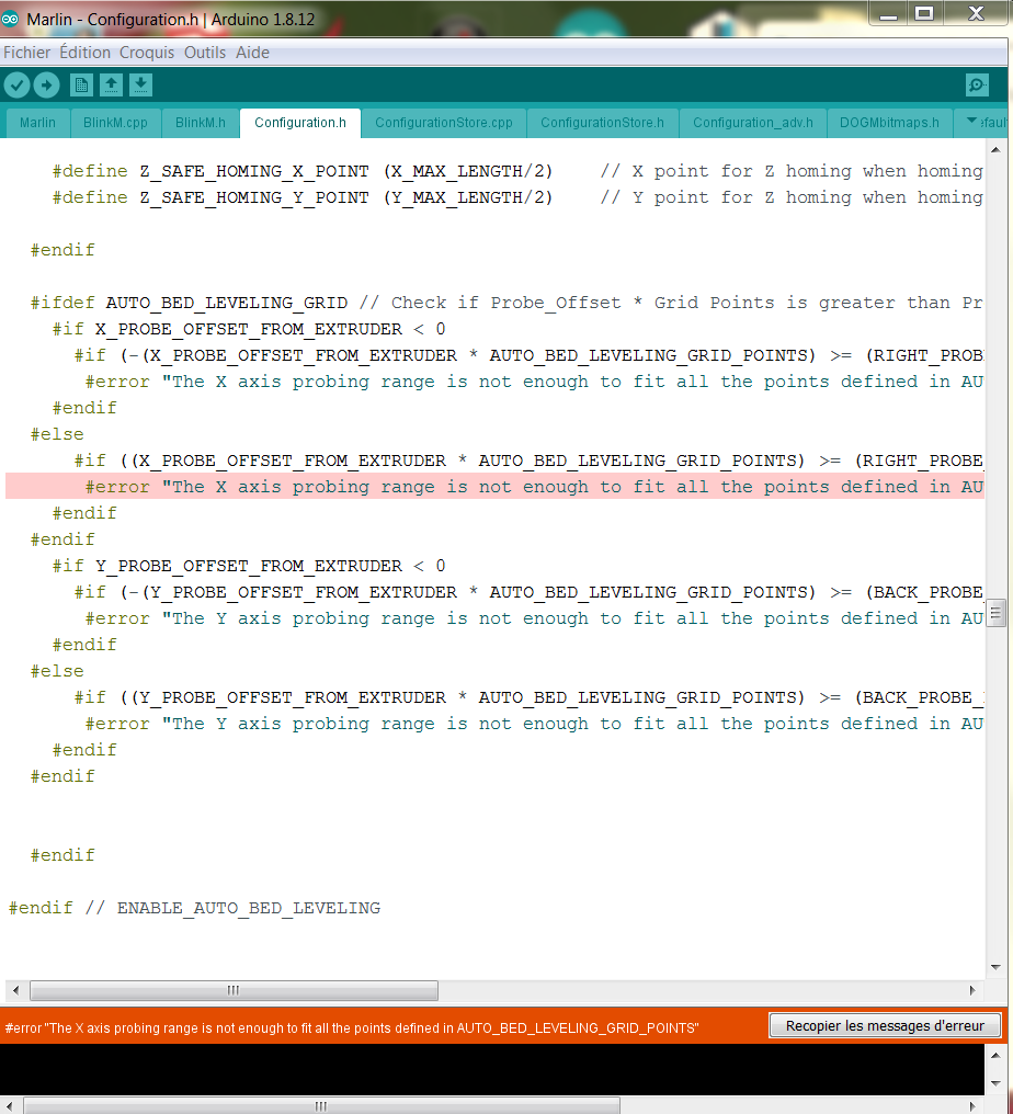

I did the 4 steps according to the manual, but when I checked the coding it gave me an error.
You can see the pictures, I did the same thing as the manual.
Where is the problem ?
Thanks
Thanks

Sorry, I just confirmed that there is no need to change the firmware, this firmware supports 3dtouch, you can just connect the auto-leveling sensor and do the setup on the LCD screen.
